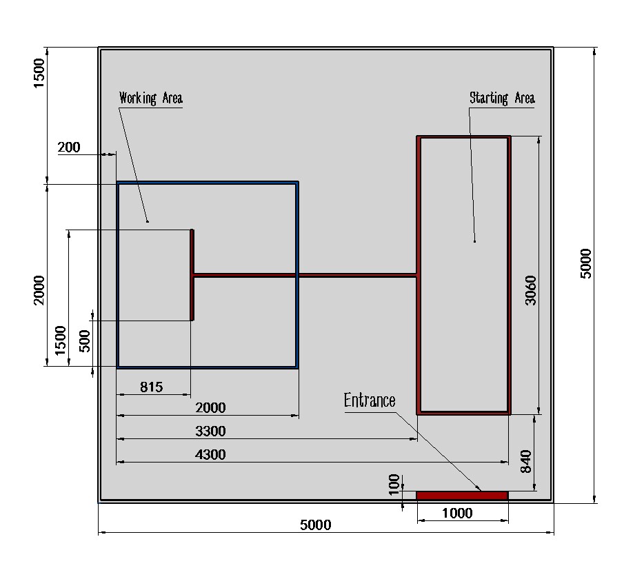

1. The size of the competition field for the DJI 2017 RoboMaster Mobile Manipulation Challenge is 5000×5000 mm, covered by a gray non-slip rubber mat beneath wood-based flooring. The Base and Starting Areas are marked with blue and red lines as shown below:
Figure 1: Top view of the competition field
Note: Figures are in millimeters (mm)

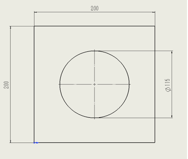

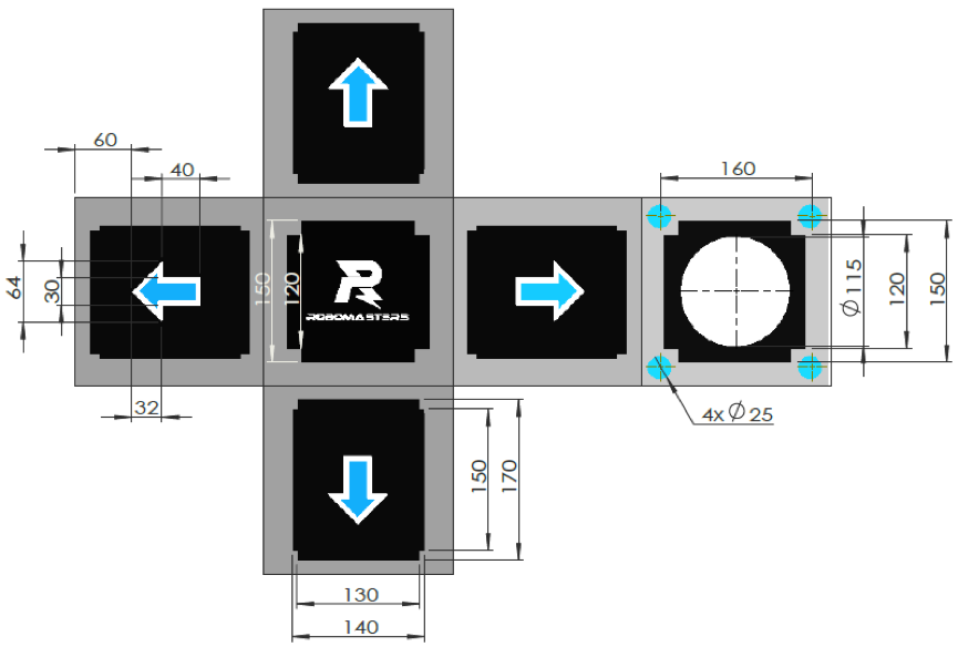

2. The size of a building block is 200×200×200 mm, made of EVA, with a hardness of 45°. There is a hole with a diameter of 115 mm and depth of 150 mm on one side of the building block. Below is an example:
Figure 2: building block diagram
Figure 3: front view of the bottom of a building block
